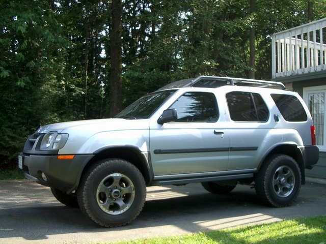

Here's a side pic with Calmini shackles and torsion bar adjustment (32" tire size).
- Scott

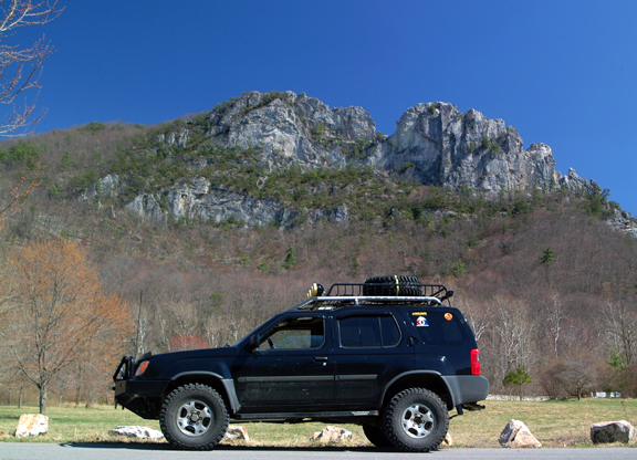

i think this is with just a t-bar crank and leafs.
then this is the full 3" lift
i find it hard to believe you couldn't find any pics of lifted xterras here. but then again a lot of pics end up being dead links sometimes.
